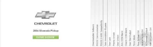

Pretty sure you wont need anything else. The Compustar has built in relays for parking lts. ign. and acc. as well as an external anti grind starter relay. As far as door locks, tach, and bypass, the blade will take care of them with one data connection. When you update the blade you can print detailed instructions for location of the data wire and features it controls.

Do i need to use the anti grind relay if the vehicle already has an anti grind built in?  I am pretty sure my truck will not allow the starter to engage if its already running.
So i can select what features I want to enable when programming the blade?  Does anyone have a list of features that are able to be programmed?
So wow.......this will be a pretty easy install if I understand everyone correctly.  12+, ground, starter, ignition(s), brake, parking lights, and class II data wire are all i need to connect to get this operational.   Any recommendations as far as splicing parts is concerned?  Does anyone make a T-harness for this vehicle?

compustar into silverado -- posted image.
