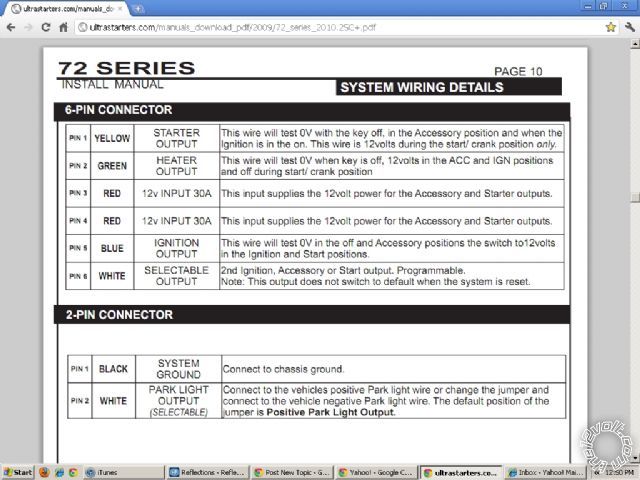

hey guys i have a couple questions i hope you can help me with.
i have a 2005 Xterra SE that i installed a Ultra start 1272 remote starter in.
the truck starts and the lights, horn, locks all work.
my question(s) is i only hooked one starter wire up and one accessory wire up. and my heater blower doesn't work when the truck is remote started. is this because i need to hook up the 2nd accessory wire?
and should i use the selectable output on the remote starter for the 2nd starter or the 2nd accessory. (does it matter one way or the other if i add a relay to the 2nd starter or to the 2nd accessory)
thanks, Jared
2005 xterra with ultra start remote start -- posted image.
Platinum - Posts: 7,827
Posted: December 27, 2011 at 12:03 PM / IP Logged
You should have two Starter wires and two Accessory wires on that Xterra.  Program the U1272 White thick gauge wire on the
6 Pin connector for Starter2 ( Menu3, Item1, Opt1 ) and connect the White wire to the Xtera's Light Green Starter2 wire.
Obtain a 30/40 Amp SPDT relay and 20 Amp fuse.  Wire as follows :
Relay Pin 85 to U1272 (-) AUXILIARY 1 OUTPUT Black wire on 9 Pin connector
Relay Pin 86 and 87 to +12V constant thru 20 Amp fuse
Relay Pin 30 to Xterra GREEN/ YELLOW Accessory2 wire at ignition harness
Relay Pin 87A not used - insulate
Program the U1272 Menu1, Item5 to Opt 1.
