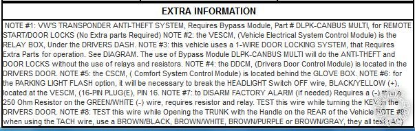

Can someone provide me with remote start wiring info for a Volkswagen Tiguan 2009. I plan to use an idatalink ADS-AL CA 64 and tap the factory key antenna and looping around the key fob(not the valet). Other than that, is there any other particular info I should know ?
Thank in advance for any info you can provide !
pomerlo

Ohh never mind I found this on Bulldog site.. is this correct ??
vw and transponder bypass -- posted image.

only way to know for sure if it is correct is to test and verify the wires you are asking about with a digital volt meter.
