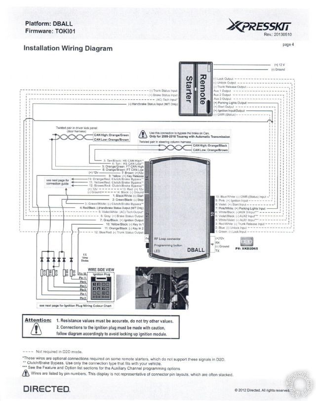

Hi i have a dball and viper 5704 and a 556uw im installing in a 2005 audi a8 i got the dball in and programed it works as it should but i can not get the remote start to work. i dont get any dash lights about the only thing i can hear is the key cylinder click. the dball direction only calls for hooking up a pos and neg plus ignition input output and parking lights hard wired to the dball but its got to be something im missing about connecting the 5704 any help would be appreciated

Is this connected D2D?
Put a DMM on the on the Ignition output of the 5704 when trying to remote start.
If there is no output, you may have to connect the H3/6 Red wire. This is the 12 volt input for the Ignition output.
I did a 2010 Jeep Liberty recently, D2D, and that diagram did not list connecting the ignition input wire of the remote starter. After testing, I connected the H3/6 and the it worked.

Yes it is in d2d and i will check that out in the morning

Had to connect the H3/6 wire to get power to the h3/1 but im still not getting and thing other than some relays clicking.

Could you list all of your connections from the 5704 to the car and your DB-ALL connections. Also the connections of the 556uw.
Are your connections soldered or crimped?
Are you getting any flashes from the parking lights? If so how many?

The 556uw blue wire is connected to the blue status wire of the remote start. The remote start h3/6 wire of the viper 5704 is connected to constant to power the ignition pink
