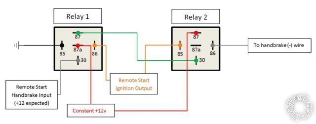

I need a 12volt positive signal from my handbrake when it is in the on position for my clifford intellistart...it currently has a earth signal when on and i need help as to what i can do ?
I also need to wire up a relay to use on an acccesory output from the alarm to switch my side lights but i know i cant go straight from the alarm as the output is only rated at 200ma

i have a wire on the intellistart that must have a 12volt feed when the handbrake is on if used with a manual car...g5 concept650 mk2

You can use two 5 pin relays to do this. This circuit will always send a +12v to the remote start, but when the remote start is activated, it will check the handbrake. If the handbrake is not set, it disconnects the +12v source to the remote start. Here's the pinout:
First Relay:
Pin 85 - Ground
Pin 86 - Ignition output from remote starter
Pin 87a - Constant +12v
Pin 87 - to pin 30 on relay 2
Pin 30 - to handbrake wire from remote starter (+12v)
Second Relay:
Pin 85 - from car's handbrake wire
Pin 87a - not used
Pin 87 - Constant +12v
Pin 30 - to relay 1 pin 30

thankyou bud..what type of 5pin relay do.i need?
