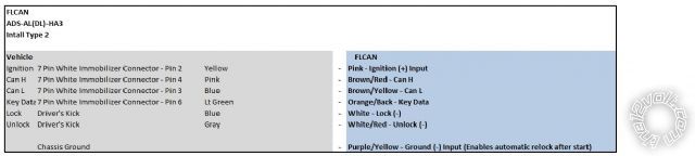

My step-daughter asked me to install a remote car starter in her 2012 Honda Civic(automatic). Although I've never done an install on a Honda, it looks pretty straight-forward. I just want some reassurance on my install and maybe some tips. I plan on installing an Compustar FT-6200s using a FLCAN bypass d2d(flashed with ADS protocol of course).
2012 civic remote start -- posted image.

Sorry if the images I clipped from my Excel spreadsheet appear kind of small. It's the only way I could post it.

That car doesn't have built-in Anti-Grind, so you might consider using the supplied Starter Kill relay and cutting the Civic's Yellow Starter wire.

I wasn't sure if the car already had anti grind protection built in or not. Now that I know it doesn't, I'll probably do the anti-grind relay.

BTW, do all my wiring connections look good for this particular install?

Your listed connections are correct.  The ADS AL-CA w/HA3 install guide should be very accurate for the wires they
list in the Type 2 diagram.
A few notes...
1.  Looks like you want to go with D2D.  Default Compustar FT6200s programming is for Tach Mode, but you must
     still do the Tach Learn procedure.   Very easy with the Compustar.
2.  The bypass module should supply the foot Brake signal via D2D, so no need to hardwire to the Civic.
3.  If you want Horn confirmations from the Compustar, connect the Horn output to the Civic.  Easy to find in the
     steering column.
4.  You can update the Firmware on the Compustar without a Blade module installed using your ADS USB cable.
     Current Version is 7.15.  The big bonus is that while you are there, you can also make any necessary changes to the
     4 programming tables plus Special Option Group 2.  PM me if you need more info.
5.  Which brings us to the Rear Defrost.  Here is the info from AudioVox :
     Rear Defrost  LIGHT GREEN  (-)  @ MICU MODULE AT REAR OF INTERIOR FUSE BOX UNDER DRIVERS SIDE OF DASH
     Just choose one of the un-used POC's, set it to Defrost Type 17 in the Special Options Group, set Menu 3-14
     and connect the corresponding wire to the Civic.  Without a Temp Probe, you can only do a fixed time after a
     remote start.  Could install a Winter/Summer switch if you felt the need.

2. Good catch. Just so used to connecting it that I forgot the FLCAN handles that.
3. Looks like it's a (-)orange wire at the horn according to the wiring on commandocaralarms.com I'll have to test it just to be sure...that is, if she wants it hooked up.
4. I just did this on my wife's '09 Wrangler. I updated the firmware on the CM6200 and flashed the ADS-AL CA bypass. I REALLY like the fact you can set the special options that way. This is also part of the reason I stopped using DEI stuff. The Compustar stuff is soooooooo much more user friendly!
5. If I have time with her car I'll look for the defrost wire and try to hook it up. If not, I'll at least set the program option that way I can always do it at a later date.
One other thing, I saw that the truck release doesn't work while remote started. I read somewhere that there's a green wire(+) in the driver's kick(I think) that can be triggered. I should be able to wire the GREEN / WHITE wire(pin 6 of the CN1 connector) to it for the trunk release as long as I change the internal jumper on the CM6200 to "trunk release" instead of "parking light output".
