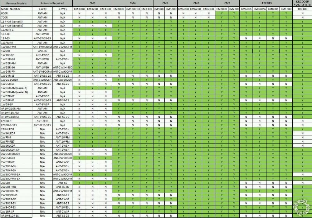

Remote compatibility: The main factor that determines Compustar remote compatibility is the antenna used. I've got a (now slightly dated) compatibility matrix I grabbed off an ebay listing a while back, I'll upload it below. Essentially, the only remotes you've got to watch out for are those that use the ANT-1WSS-25 and ANT-SS-25 antennas which use 6-to-6 pin cables (6-pin controller plug, 6-pin antenna plug). Because of the cable, these antennas require a controller with a 6-pin antenna port (newer controllers only ie. CM7000/CM7200, *not* LT series such as CM600/CM800/CM900). Some remotes that use these antennas are the 901 and T10 LCD 1-Mile remotes. Side note, Compustar's newer DSS antennas/remotes (3-mile T11, 2-mile Pro R3, 2-mile Pro G15) have 4-to-6 pin antenna cables and are compatible with newer 4-pin only controllers (LT series, DC series).

That compatibility matrix I mentioned:
09 Subaru Legacy Compustar remote start/alarm -- posted image.

I’m not too familiar with the older stuff but it looks like the 2w900fm antenna (and corresponding remote) should work with pretty much any of the new controllers (based on it’s compatibility with the LT series).
