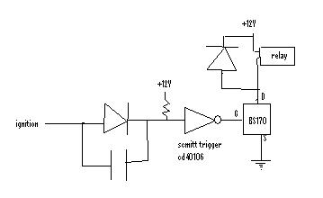

dualsport
Silver - Posts: 983
Joined: September 27, 2005
Posted: June 08, 2009 at 9:26 AM / IP Logged
open/closing power folding mirrors -- posted image.
Something like this could be done to output a short pulse when the ignition is turned off. The resistor and capacitor just needs to be selected to get the time you need for folding the mirror. After it times out, the relay should remain off until the ignition is cycled again.
If you want to try it without any solid state components, you could try doing it brute force by using a large cap in series with the ignition input, and connect that to the low side of the relay. The high side of the relay would go to a 12V source. The cap in series would limit the amount of time the relay can stay on. Also put the diode across the cap to discharge it when the ignition goes high. Whether you can get away with this or not depends on how long a pulse time you need to do the folding. It'll be limited by the draw of the relay and the size of the cap.
