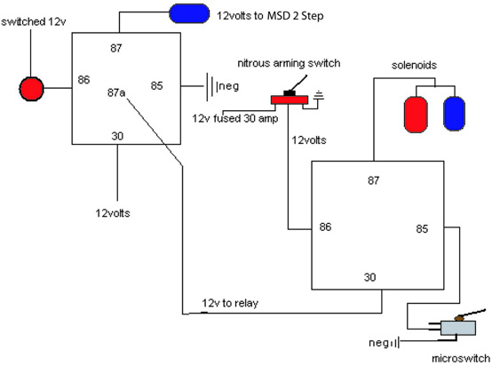

Right now I have the 2 step wired along with the nitrous and all works perfect. I want to add the line lock activation to the 2 step activation. I need to know if I can do this with a N/O switch as described in #1? I included a pic of how I have it wired right now.
Thanks for any and all help! Line Lock with 2 Step, But Separate, Nitrous -- posted image.

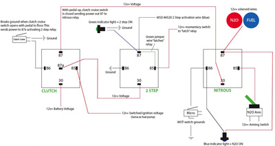

Here is how you can reverse the action of the clutch switch.   I will read the rest later tonight and see if I can come up with a solution for the rest.

So that will break ground when the clutch goes to the floor sending power through the relay to the 2 step relay? Just want to be sure I understand it, not questioning you.

Does this look correct? Line Lock with 2 Step, But Separate, Nitrous -- posted image.

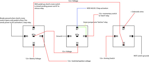

Posted: July 30, 2009 at 3:34 PM / IP Logged
Revised.

You said you needed the clutch switch to operate exactly opposite of the way it is.  The relay makes it exactly opposite of how it is.  I can't see your picture.  If you can redraw it using Microsoft Paint, and save it as a GIF file, it will be a smaller file and be able to post it larger and be below the file size limit.

Ok I wired up everything aside from the nitrous. The 2 step relay will not stay "latched" when I release the momentary button on it. Why would this be? Everything else works exactly as I thought t would from the wiring diagram. But if I do not hold the momentary button down that relay comes unlatched.
Platinum - Posts: 13,725
Posted: August 02, 2009 at 5:48 PM / IP Logged
If the picture you posted is of the 2 step relay,  I see nothing that is supposed to keep it latched.

Yes that is the pic, and the relay I have in question. I have the jumper wire between 87 and 85. The way I was told by MSD is that once 12 volts is sent to 85 via a momentary switch I could then release that switch and the jumper would keep 12 volts at 85 via the jumper to 87? I am thinking their wiring diagram is wrong....
How would I latch that relay?

Got it working as wired in the diagram I posted. Turns out the jumper wire was not fully connected. Redid the crimp and it works 100% as it should!
