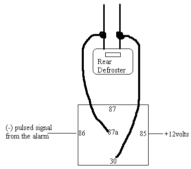

So can I do something like this?....assuming that the rear defroster has 2 wires. If it has more than that, how will I determine which 2 to use?
Thanks guys!

xetmes
Silver - Posts: 586
Joined: May 18, 2003
Posted: October 16, 2003 at 4:11 PM / IP Logged
yea thats what i mean assuming just 2 wires, pull the switch out and take a look, do some measurements with a meter to determine if that will work, always want to use the least invasive technique if it will work...
also throw a diode on that coil Momentary to const question:  for defrost -- posted image.
