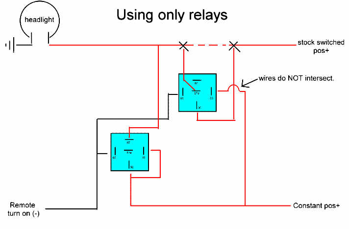

jc18750, Thanks for repsonding to my post, that was the idea I had in mind, but ultimately, what I would lke to do is have Illuminated entry when I arm/disarmed. Each arm and disarm cylce would last 30-60secs. I'm be afraid when I disarm, I get in to the car, start it up and turn on the headlights I would fry the wiring because of oversupplying current to the headlights. Would a diode work to isolate the current? My other idea involves using relays and removing the stock wiring from the headlights, but first I'll have to check to see if the stock setup uses a switched negative.

a diode would work to isolate the current, but you'd need two for each light. you could also pull it off using relays 2, each side..switched power -- posted image.

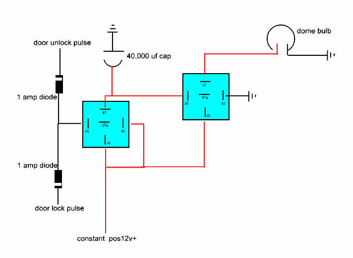

the above diagram would work if the neg is NOT switched. this diagram below is for your dome light on for 30 seconds when you arm/diarm your alarm.switched power -- posted image.
