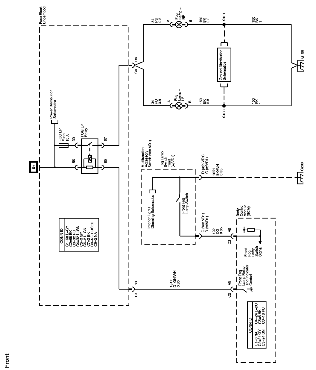

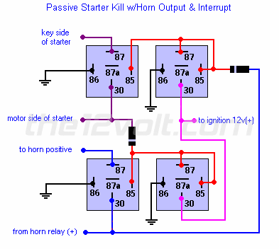

Ok one more question, if I use the factory fog light switch, do I use the 2 set relay diagram like below to still mantain factory use of my fog switch?
button starter kill -- posted image.

Posted: March 12, 2009 at 4:54 PM / IP Logged
And do I want to catch my lead directly off the switch or after BCM...button starter kill -- posted image.
