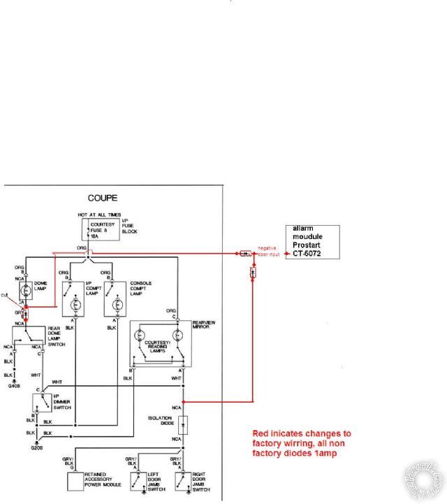

The manual says two parking lamp flashes indicate failed remote start, that's all is says.. really helpful eh?? Here is a diagram of what I have done, were do I add the rearm wire exactly? Thanks for all you help! -Jamie

prostart ct 5072 1994 camaro rap -- posted image.

I fixed it! The problem was that I pulled power from a wire that red 12 volts hot only for a minute after a door was opened, must have been a wire to for retained accessory power, and I used it to power my clutch bypass relay. All I did was hook that to a constant 12 volt feed and now it works great! I guess thats what I get reusing a relay that was there from the old alarm system! Oh well
