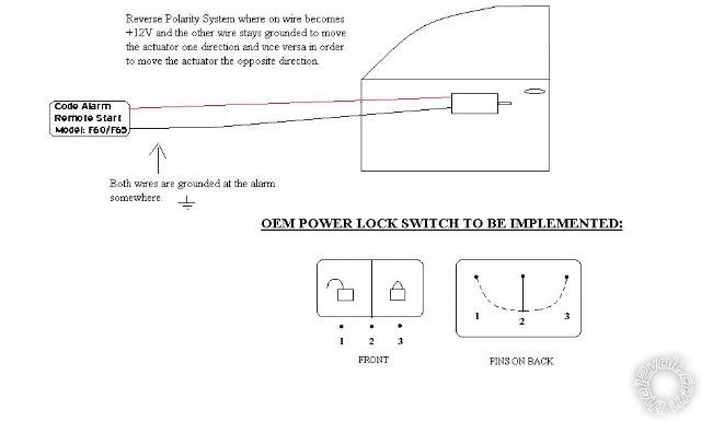

Hello guys, I am trying to install the OEM power locks on my 01 Saturn Sl2. It has aftermarket alarm/starter with aftermarket actuators. Everything was manual before. The current alarm locks all doors and unlocks all doors at the same time. I have included a picture with a drawing of what I need with an explanation and the type of current system.

Ground the centre pin and each pin 1 and 3 go to a trigger wire respectively.

That would not work because there would not be a potential difference anywhere so the actuators would not move. Or am I missing something?
The wires that come from the alarm to the actuators are grounded and a single wire becomes +12v when the button on the remote is pressed but when no button on the remote is pressed, both wires remain grounded on the alarm.
I am planning on doing this, this weekend but I cant figure out how to wire this. Thanks in advance!!!

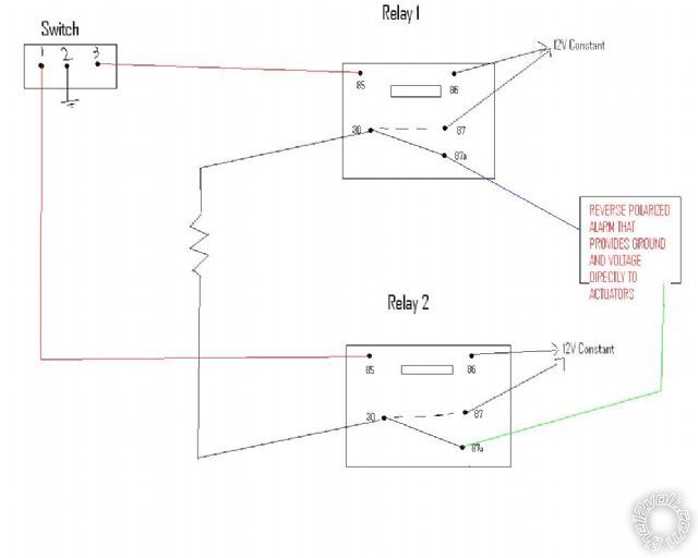

The Alarms provides the ground and the 12voltage to the actuators. So the cables go from alarm to actuators directly!!The alarm always has the two legs grounded. Then one becomes energized depending on which button on the remote is pressed. I came with something up though, can you guys check if it is right?
I am a mechanical engineer so I had to draw the relays how they physically worked since I have not memorized the pin schematics yet so please bare with me!!!haha. Thanks in advance!!!

Then the switch you've shown will need relays to be wired in parallel with your lock outputs from the alarm, alternatively convert your alarm outputs t to neg, bring them up to your switch then to the relays, 87a is grounded.

The circuit that I drew worked with no problems. Thanks for the help.

But you've shown external relays no inernal so yes that diagram will work it's what we said from the beginning.
