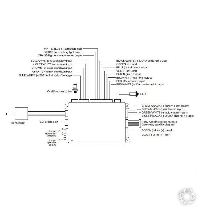

I went over the Python 571XP manual and I can't find an output would pulse (-) after remote shut down. Any suggestion ? python 571xp and 05 camry door trigger -- posted image.

GREEN / WHITE factory alarm rearm.
DEI units seem to have super-weak outputs, and the circuit on the Camry seems to draw a fair bit of current...I think you're going to have to use a relay.
And if you pop off the driver's doorsill you'll see what I mean. There's like a two-foot open stretch of wire harness. Just cut away the tape and find the wire you need in there.

Posted: November 19, 2010 at 9:17 PM / IP Logged
Left front door trigger, RED / green. Get it in the harness Chris describes....

Posted: November 20, 2010 at 9:17 AM / IP Logged
Thank you guys,
I'm planning to use the relay.  I'll find the wire.
