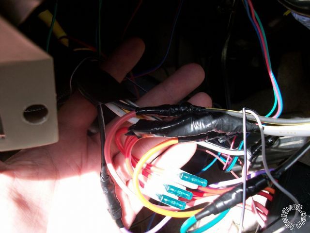

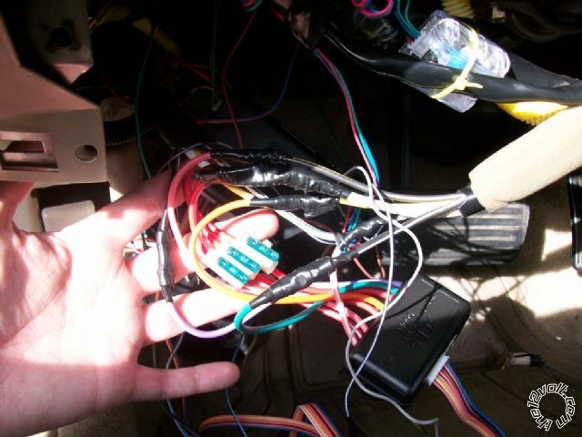

I just finished installing an AVITAL 5103 (DEI) alarm/remote start in my 94 accord lx.I have everything working fine (security) The problem im having is when I press the starter button on the remote, the start sequence initiates but doesn't crank, the dash lights light up, fuel pump kicks in, and right when its supposed to crank, I hear 1 click from the starter and then it shuts down and repeats this cycle 2 more times.If i start the car with the key, press start button on remote, and remove key from ignition the car stays running until i tap the brake (the way its supposed to).
the following are the connections i've made:
H/1- (+) STARTER OUTPUT (PURPLE) CONNECTED TO BLK/WHT (STARTER SIDE)
H/2- STARTER INPUT (GREEN) CONNECTED TO BLK/WHT (IGNITION SIDE)
H/3(2 FUSED WIRES)- (+) 12V INPUT FOR HIGH CURRENT OUTPUTS (RED) CONNECTED TO WHT (CONSTANT 12V)
H/4- (+) ACCESSORY OUTPUT (ORANGE) CONNECTED TO YELLOW (ACC)
H/5- (+) IGNITION OUTPUT (PINK) CONNECTED TO BLK / YELLOW (IGNITION)
H/6- (+) SECOND IGNITION ACCESSORY OUTPUT CONNECTED TO WHT/BLK (2ND IGNITION)
H/7- (+) 12V INPUT CONNECTED TO WHT (CONSTANT 12V)

That car has only one ignition wire and two accessories. I usually don't even power up the BLACK/ white second accessory, as it only powers the radio anyway.
So, in programming you should set the pink/white to act as an accessory output, rather than ignition. But even if it's set as ignition, that car should still start.
I believe you that you didn't get the purple and green mixed up, but even with some experience behind me I do get those wires backwards from time to time. I'd go and take a fresh look at that just to be 100% sure. Purple goes into the car's body, green goes toward the keyswitch.
If all else fails, time to test the purple wire to make sure it really is putting out power.
