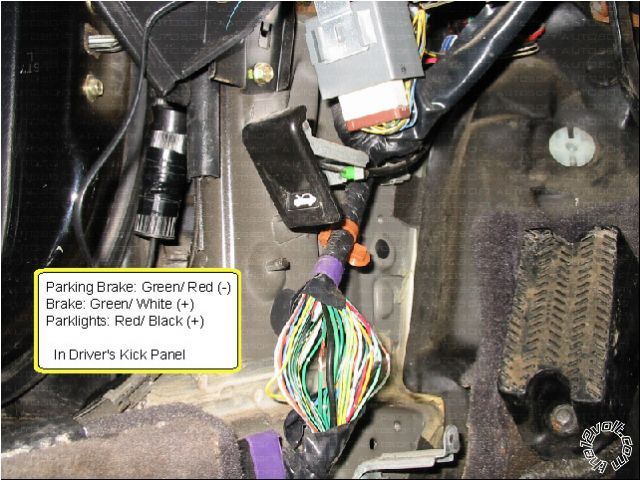

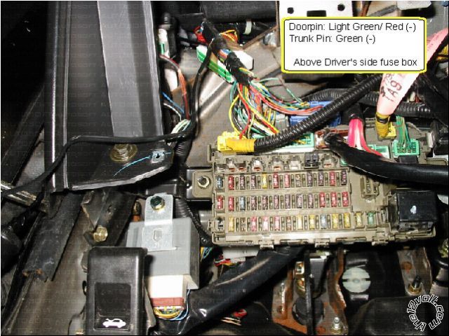

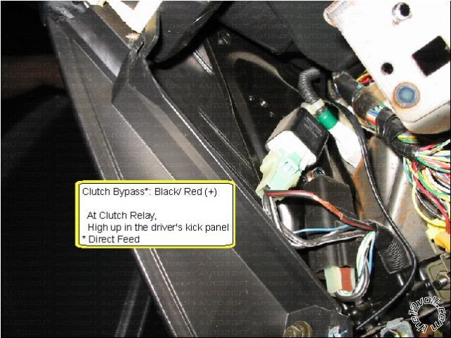

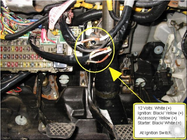

syl20rochon
Copper - Posts: 298
Joined: October 16, 2009
Location: Ontario, Canada
Posted: April 24, 2011 at 9:05 PM / IP Logged
5902 on manual integra -- posted image.
