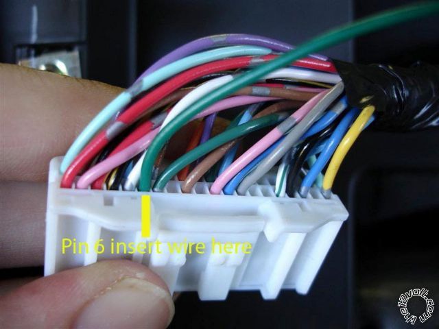

try this, Insert wire into pin 6 at the cluster if its not already there:
2011 nissan frontier vss pin location -- posted image.

thanks, i actually believe that i found it through process of elimination. it looks like it was there at the cluster in the spot that you want me to add a wire.
funny though because im pretty positive that it was not at the radio harness because it was just a standard old style nissan plug(the one with two plugs) and not the new style found on some of their cars, even though my factory system was not the base model. i still havent 100% confirmed that i have the right wire but it did make my navigation unit stop bothering me about not having it hooked up so i assume i did something right.
