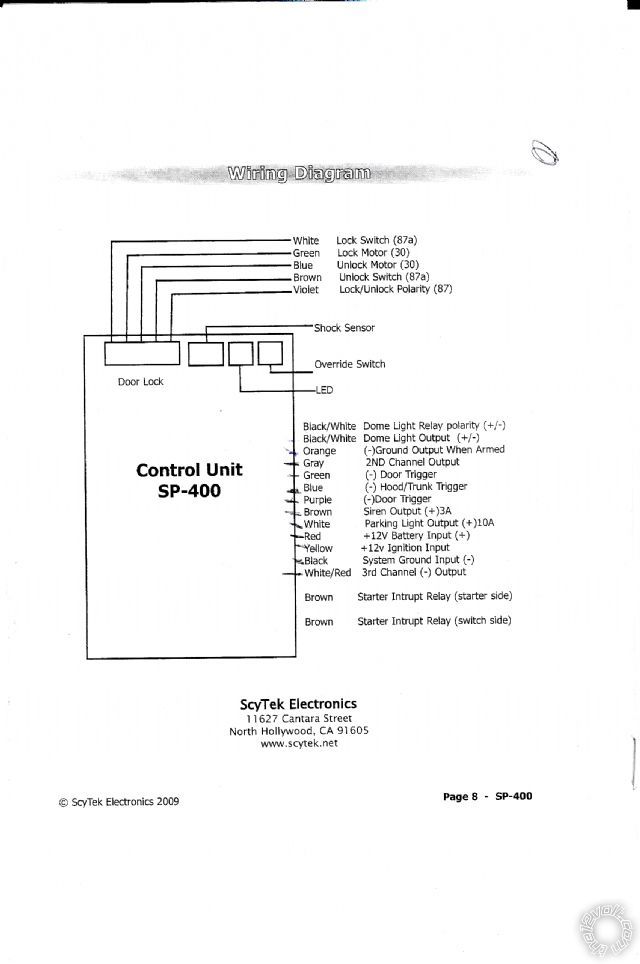

davanthony
Joined: September 28, 2013
Location: Maryland, United States
Posted: September 29, 2013 at 8:37 AM / IP Logged
scytek sp 400 -- posted image.
Platinum - Posts: 7,827
Posted: September 30, 2013 at 7:10 PM / IP Logged
Can't find the full manual for this alarm but...
BLACK/ White Dome Light relay input Chassis Ground
BLACK/ White Dome Light Output   RED / WHITE (-) IN DRIVERS KICK PANEL,
Orange (-) GWA   not used
Gray (-) 2nd Channel Output not used
Green (-) Door Trigger      RED / WHITE (-) IN DRIVERS KICK PANEL,
Blue (-) Hood/Trunk Trigger to supplied & installed hood pin
Purple (-) Door Trigger ??? not used    ( think this is really the (+) Door Trigger )
Brown (+) Siren Out  Scytek siren
White (+) Parking Light Out DARK GREEN (+) IN DRIVERS KICK PANEL
Red +12V constant White @ IGNITION SWITCH HARNESS
Yellow (+) IGN In   BLACK / YELLOW (+) @ IGNITION SWITCH HARNESS
Black Chassis Ground      Chassis Ground
WHITE/ Red (-) 3rd Channel Out        not used
Brown Starter Int ( car side ) BLACK/ WHITE (+) @ IGNITION SWITCH HARNESS \____ cut wire
Brown Starter Int ( Switch side )    BLACK/ WHITE (+) @ IGNITION SWITCH HARNESS /
Locks
White Lock 87a     not used
Green Lock 30      LIGHT GREEN (TYPE B) IN EITHER KICK PANEL
Blue Unlock 30     GREEN/ RED (TYPE B) IN EITHER KICK PANEL
Brown Unlock 87a  not used
Violet Lock/Unlock Polarity ( 87 )   Chassis Ground
