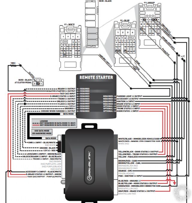

I have ordered idatalink bypass module to go along with the viper 5704 for my 2011 camaro and before i dive in i had a couple of questions Im no pro (clearly) so any help is much appreciated Xmas broke me..lol
What does the squiggly line going to the clutch pin 2 with the 180 over it (diagram top left angle) and i think i know but 2nd do i cut the immobilizer data wire to the car then connect wire to cut wire then other to pin 2 (diagram top right)again thanks

Thats the symbol for resistor so 180 ohm resistor on the (-) starter output to do clutch bypass.
White red splice into GREEN/ red will face the vehicle and WHITE/ black will go to the other side.
Not a real easy vehicle I've done a couple but there's not a lot of room to work and trying to solder in the vehicle can be a PITA. Make sure you double check your wires are away from any moving parts in and around the steering column.
