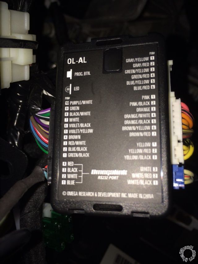

unit pics:
2011 traverse excalibur rs-330-edp / ol rs232 -- posted image.

I am going to look at it again and see if there is a plug where the switch goes. This would be the blue port on the RS330 module right?
prdjr165
Copper - Posts: 293
Joined: October 31, 2002
Posted: February 16, 2015 at 4:22 PM / IP Logged Link to Post Post Reply Quote prdjr165
the blue 2 pin port on thr RS33O is correct.
