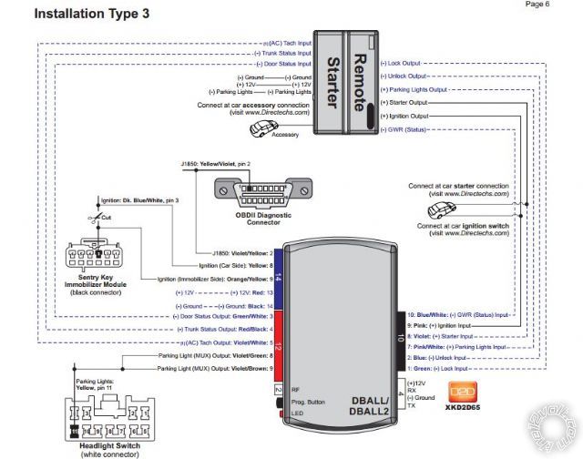

Here is the schematic for the dball2 which shows the dotted wires as required for w2w. I'm sure you have already seen this before. Db-all W2W, 2004  Jeep Grand Cherokee -- posted image.
