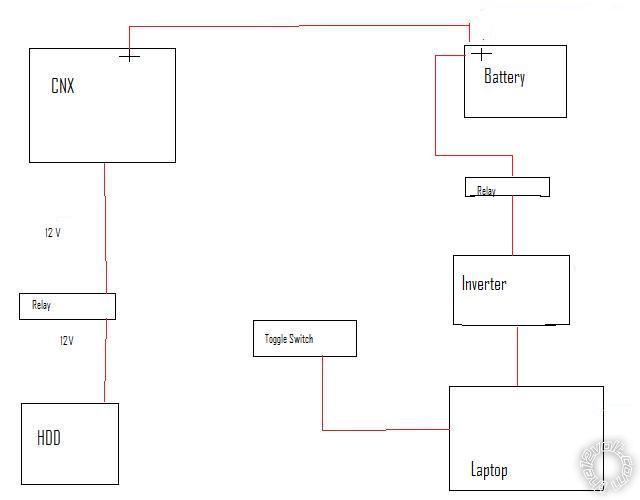

Hey guys,
While I have a good amount of experience installing my car PC's for the last year or so, I'm just starting to learn about relays and how they work. Currently I am using a laptop with a power inverter which is wired to my car battery to power the laptop. I also use a carnetix power supply to provide 5v of power to my 8 port USB hub, as well as the 12v line to power my external HDD. The main line on the carnetix is broken for some reason, therefore it doesn't power my laptop.
The problem now, is that when I power on my car, I need to hit buttons to turn on the power inverter, as all as a button for the HDD, and finally flip the toggle switch from my laptop which I mounted in the arm rest.
I would like to use relays to turn all of this on when I turn the ignition on. I've enclosed a diagram (although a bit juvenile) of how I think it should work (from what little I understand of relays), but am still unsure of how to make the laptop turn on by itself. Can I use the IGN/ACC that runs through my car for that, or do I need to make use of the ACPI wire from the carnetix?

Is there a Year,Make,Model in there some where...? Do you have the ability to verify wires...(+,-)...Or will just the wiring of the relays be sufficient...? Can the inverter be on whenever the car is on...Im guessing what you mean is on the inverter...You have to hit the toggle switch to turn it on...Is this just a ON/OFF switch...Or is it a momentary switch...? Do you want the ability to turn these off / on while driving...Or is on when car starts...and then off when car is shut-off good enough...? And maybe elaborate a little on the switch for the HDD...Toggle,momentary...etc...How is it currently wired...?

And I can't see why you would need more than 1 relay and don't you mean ACC(depending on the vehicle) rather than ignition?

Oh OK then, 12volt constant at whatever amperage required to 30, ign or ACC trigger wire to 86, ground to 85 and output from 87 to BOTH units, a) we still don't know what car this is, b) I'm buggering off to watch telly, poster on security section Viper 5301 problems has really wized me off, family must have come from Norwich via Kentucky.
