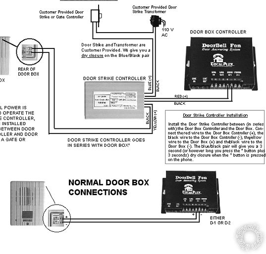

Like Kevin said, the dry contacts shouldn't show anything on them if left unconnected. We were assuming the description was accurate, but after poking around a bit, it appears you're missing the door strike controller as shown in this diagram that I found - (your other thread on gardenweb also came up- intercom wiring -- posted image.
The extra door strike controller shown is probably a relay, so your Door Fone output (which is NOT a dry contact but a low output control for a relay) is not able to drive the door solenoid directly.
If you check that the red output from the door fone is 12V, you can simply add a relay and the COM and NO terminals (30 and 87) will provide the "dry" contacts you need for your connection.
