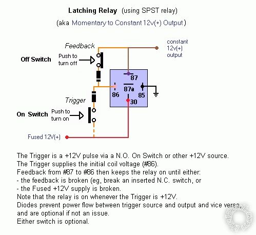

Why not just a latching switch to control a normal relay?
Otherwise the following provides a toggle/latching signal, but you'd probably have to add a transistor etc to handle the relay's coil current....
latched on/off momentary w/ brake kill -- posted image.

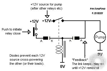

The following are almost equivalent latching relay circuits but for +12V output.
To [i[]invert for a grounded output, a second SPST relay would be added to the output - ie, ouptut to #86; ground to #85 & #30m with #86 being the grounded output when the first relay is latched.
The circuit diagram shows a pump as the output whereas the wiring diagram shows the +12V output with the pump omitted, and includes an optional Normally Closed momentary switch to break the circuit if wanting to do so without removing the main +12V power.
FYI - the two +12V sources in the first circuit diagram can be the same (as indicated by the dashed interconnection in the second wiring diagram). It was drawn as two separate +12V sources to highlight that they could be independent.
