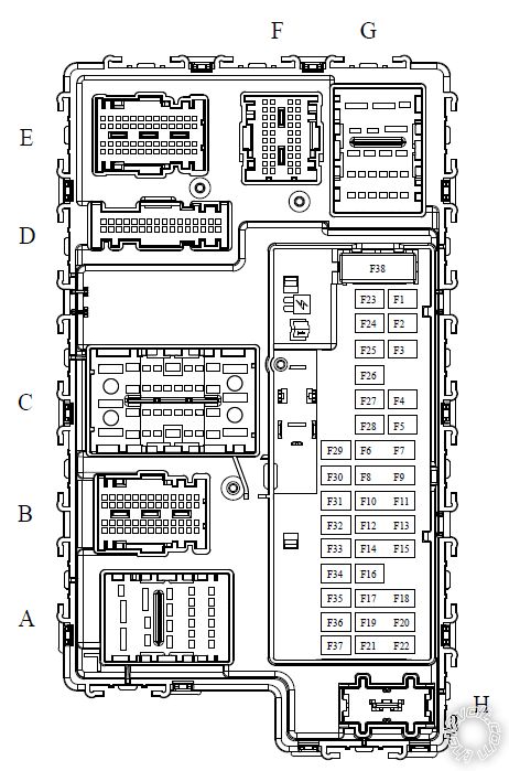

Ignition is located in connector C2280B pin 37 at the BCM in the passenger kick 2021 Ford F-150 Wiring Guide -- posted image.
Parking Lights at the headlamp switch are LIN Bus, so you'll have to go to the parking light wires at the BCM Front Parking Lights - C2280G pin 3 2021 Ford F-150 Wiring Guide -- posted image.
Driver Rear Parking Light - C2280E pin 25 2021 Ford F-150 Wiring Guide -- posted image.
Passenger Rear Parking Light - C2280E pin 51 2021 Ford F-150 Wiring Guide -- posted image.
