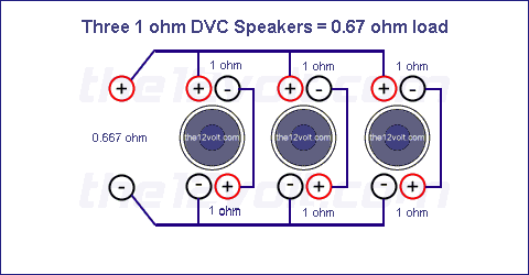

Three 1 Ohm Dual Voice Coil (DVC) Speakers Wiring Diagrams
top of page Three 1 Ohm Dual Voice Coil (DVC) Speakers
Option 1 (series/parallel) = 0.67 ohm load
Voice coils wired in series, speakers wired in parallel
Recommended Amplifier: Stable at 1/2 ohm mono
Three 1 Ohm DVC Speakers = 0.67 ohm load
