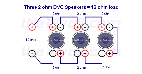

Option 3 (series) = 12 ohm load
All voice coils wired in series
Recommended Amplifier: Stable at 4, 2, or 1 ohm mono
Three 2 Ohm DVC Speakers = 12 ohm load
