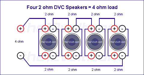

Four 2 Ohm Dual Voice Coil (DVC) Speakers Wiring Diagrams
top of page Four 2 Ohm Dual Voice Coil (DVC) Speakers
Option 1 (series/parallel) = 1 ohm load
Voice coils wired in series, speakers wired in parallel
Recommended Amplifier: Stable at 1 ohm mono
Four 2 Ohm DVC Speakers = 1 ohm load
Option 2 (parallel/series) = 4 ohm load
Voice coils wired in parallel, speakers wired in series
Recommended Amplifier: Stable at 4, 2, or 1 ohm mono
Four 2 Ohm DVC Speakers = 4 ohm load
