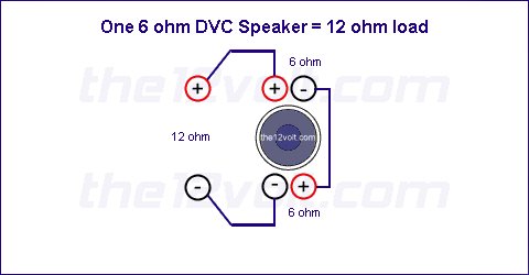

Option 1 (parallel) = 3 ohm load
Voice coils wired in parallel
Recommended Amplifier: Stable at 2 or 1 ohm mono
One 6 Ohm DVC Speaker = 3 ohm load
Option 2 (series) = 12 ohm load
Voice coils wired in series
Recommended Amplifier: Stable at 4, 2, or 1 ohm mono
One 6 Ohm DVC Speaker = 12 ohm load
