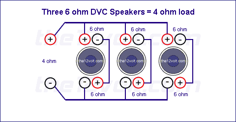

Option 2 (series/parallel) = 4 ohm load
Voice coils wired in series, speakers wired in parallel
Recommended Amplifier: Stable at 4, 2, or 1 ohm mono
Three 6 Ohm DVC Speakers = 4 ohm load
