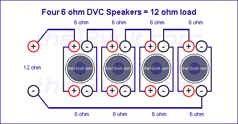

Option 3 (parallel/series) = 12 ohm load
Voice coils wired in parallel, speakers wired in series
Recommended Amplifier: Stable at 4, 2, or 1 ohm mono
Four 6 Ohm DVC Speakers = 12 ohm load
