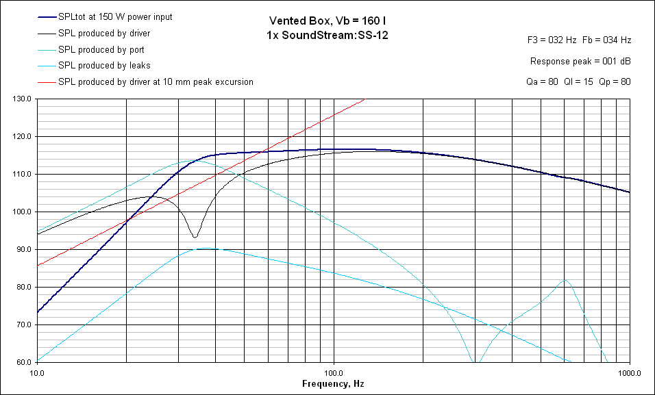

Here is an example that I found in the Unibox database of a ported response that is great SQ:  vb_response_soundstreamss-12.gif
The Fs of this Soundstream SS-12 is 32 Hz, the box Fb is 34 Hz, and it uses a port diameter of 6" (which could be configured as a slot instead) with a length of 7".  The box volume is large but reasonable at 5.6 cu ft.  With this example, you can see that you normally need a larger enclosure and will add more weight to the vehicle to get such a smooth response.  But the benefits are a short port length and, of course, SQ.  I don't know if this particular sub is even made anymore, but it does work well to show an SQ response in a ported box.
