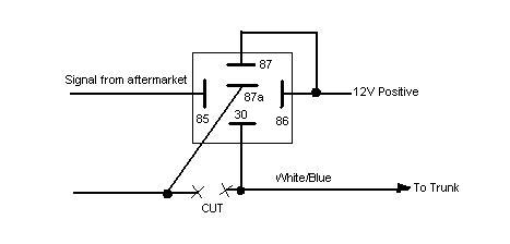

i want to know how to connect the relay for trunk release for 2005 toyota camry

if it is a neg (-) trunk release wire in the car,then just run you trunk release wire from your unit directly to it.
If the car requires a pos(+)trunk release then try this.
term 85.trunk release wire from remote start
term 86.12volts (+)
term 87.12volts (+)
term 30. out to trunk release wire in car

Its a WHITE/ Blue wire in the bottom white 12-pin plug in the driver's kick. You need to do this reversal style.
2005 toyota camry -- posted image.

I connected mine as per the above digram from Big Dog but also connected the green-white (key sense) wire to term 85 in order to kill the alarm . Worked like a charm.

Exellent2005 toyota camry -- posted image.

""Its a WHITE/ Blue wire in the bottom white 12-pin plug in the driver's kick. You need to do this reversal style. ""
I'm pretty sure it's a blue plug....
