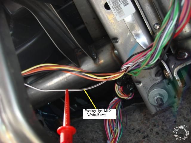

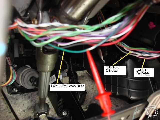

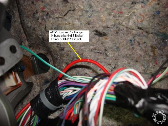

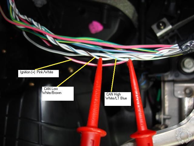

The ADS CH4 install guide has the wires / color.  The 2008- 2010 are the same.  Here are some pictures from a 2010 Dodge Grand Caravan.
Just remove the lower dash panel and the metal knee plate to gain access to these wires.

The Parking Light MUX is in a bundle coming from the back of the light switch.

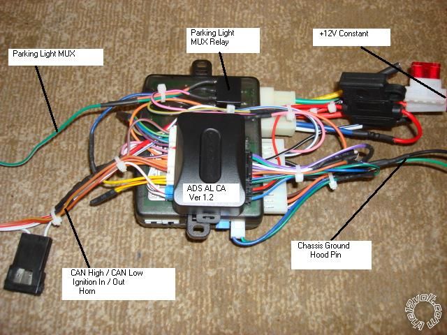

Most of your connections from the remote start unit ( brain ) will go to the iDatalink bypass module.  I prefer using the W2W method.  As shown in the Type 2 diagram, the R/S parking light wire will connect to the White Parking Light wire of the bypass only.  The same for Lock, UnLock, and the sliding doors.  The bypass controls most everything thru Data.
The only connections from the remote start brain directly to the car are +12v constant power, ground, Horn and your Hood pin switch.  The posted pictures show the power and horn connections.  The bypass supplies the remote start brain with the Brake pedal signal, an EBrake signal and a Tach signal.  If the remote start unit is also an alarm, the bypass supplies Door and Trunk status.
The only connections from the iDatalink bypass are the CAN High and CAN Low wires, the Ignition In & Out wires, and the Parking Light Mux wire.  The RAP shutdown wire is optional and the Drivers Door Pin wire is pretty easy to find.
The iDatalink module makes the install almost too easy...
Here is an Ultra Start remote starter and iDatalink module connected in the W2W mode almost ready for install.
2009 dodge diagram r/s diagram -- posted image.
If you haven't used the ADS AL CA before, remember to set the Mode as described in the install guide top of Page 6 before trying to program it to the vehicle ( bottom of Page 6 ).  Unless the remote start unit you are using can be programmed to a fixed 3 second starter output, set it to Tach mode and do the Tach Learn before attempting a remote start.
