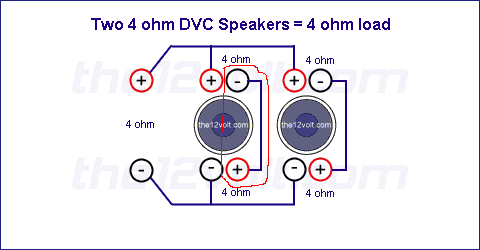

Ok so what your saying is i connect both subs in combination series/parallel as shown in the below diagram and hook it up to the mono output of the amp.
I hav a little confusion in the diagram. in the connection tht has been circled do i hav to connect the +ive of 1 coil to the -ive of the same coil??

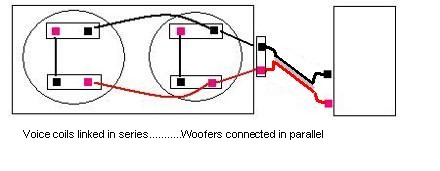

The polarity symbols + and - that are close together represent a voice coil.  So no, that diagram does not show what you asked.  By the way, use a single strand of speaker wire to make connections.  Here's another way to look at the same wiring diagram:

Ok cool thanks that diagram clears things up
i've hooked it up to the amp that way and it seems 2 be running fine. i just hope i'm not straining the amp too much. oh and i hope it dosent matter which coil is wired in series and which 1 is wired in parallel cuz i don c any difference in the 2 terminal blocks.
