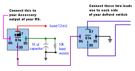

And when all else fails you can simulate pushing the switch using this :
03 accord Rear defrost wire location? -- posted image.

I will try to find the wire first but other wise i will try the two relay part!!! but will this still allow me to manually turn on the rear defrost by just pushing the button??
