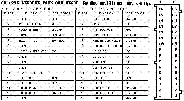

Master William
Platinum - Posts: 13,726
Posted: February 18, 2009 at 5:48 PM / IP Logged
delco radio 16201134 pinout -- posted image.

Posted: February 18, 2009 at 6:12 PM / IP Logged
That would be GREAT... I'll check tomorrow...
hivtop
Member - Posts: 6
Joined: February 16, 2009
Posted: February 18, 2009 at 6:17 PM / IP Logged
Just saw the pinout pix when the page refreashed... Da...... I should have your username... hahaha
