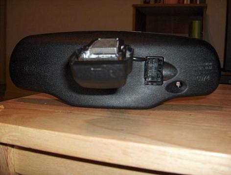

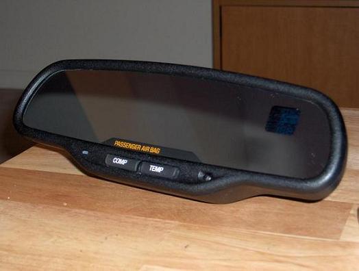

I've searched and read the long thread about this. I have a 16 pin connector on my mirror. What is the bare minimum to get this mirror to work properly? I had the power wire to pin 13 and ground to pin 8. It lit up the display but stayed lit up, like everything in the display stayed lit. Didn't have temp sensor hooked up at the time. Will that stop my mirror from not functioning or is the mirror I have messed up? It's a auto-dim with compass and temp readout. It's a Gentex 261. Here are some pics as to what I'm talking about. Last two pics is what is displayed the whole time it is on when just having a power and ground to it.

I hooked up pin 8 for ground and 13 for power and I get power to it but just everything stays lit like the above pic. Let me know what else I need to hook up. Thanks.

I posted that wiring pinout description about a year ago, after buying several used Onstar mirrors on eBay and spending a few hours figuring everything out.
In order for the temp/compass display to work properly, you'll have to hook up the factory temp probe to the mirror at pins 6 & 7. The compass is built into the mirror, and should work properly once power is applied and the compass is calibrated. I'm pretty sure you hold down the "comp" button for a few seconds until it enters the calibration mode, then slowly turn the entire mirror in several 360 circles until the display starts to show the correct direction.
If you can't get the temp/compass display to show anything other than having every segment lit up, the circuit board is most likely bad.
You can check the auto-dimming feature by putting the mirror into a dark room, hooking up power to it, then shining a bright light at the mirror glass and checking your reflection. You should see the mirror glass start to dim slowly. The reason you have to be in a dark room is that the mirror won't dim if it senses it's daylight outside - that's what the sensor on the FRONT of the mirror is for.
You can change the "airbag on" or "off" display by applying a ground to either pin 3 or 4, depending on which you want.
