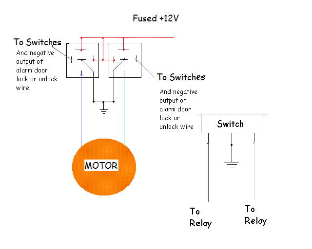

I'm a bit thrown off by the fact there's no common body ground,
Platinum - Posts: 13,725
Posted: June 23, 2008 at 5:22 PM / IP Logged
controlling a linear actuactor -- posted image.
The above was for door locks with multiple switches.  Disregard the parts about connecting to the alarm wires.

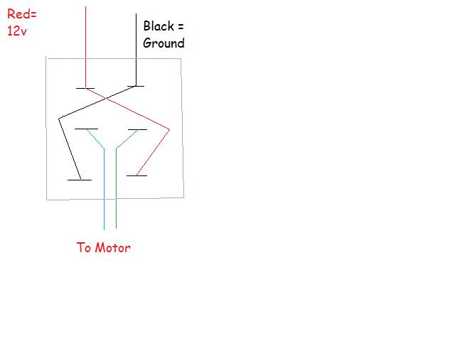

Posted: June 27, 2008 at 7:42 AM / IP Logged
Above is a Double Pole Double Throw On-Off-On momentary switch
