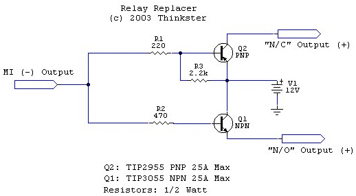

Here's the transistors that can handle more then enough current for your needs. Notice the metal tab on the part. Do NOT mount that to metal on the car, Do NOT mount them to each other. Do Seperate them with something non-conductive that won't easily melt.
