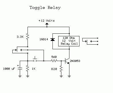

If you would like to make one yourself here is the Schematic. It is from http://ourworld.compuserve.com/homepages/Bill_Bowden/page9.htm
Latching Relay to Flip Flop -- posted image.
