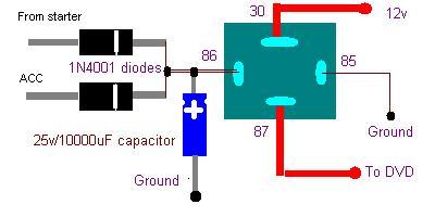

Is there some sort of alternate power supply i could install that could take over for those few seconds?

MielGibson
Copper - Posts: 74
Joined: January 03, 2003
Posted: May 26, 2003 at 1:52 PM / IP Logged
I uploaded the picture but the link is missing the .jpg extension, I don't know why.
Anyway, I hope this works.
DVD Player restarts -- posted image.
