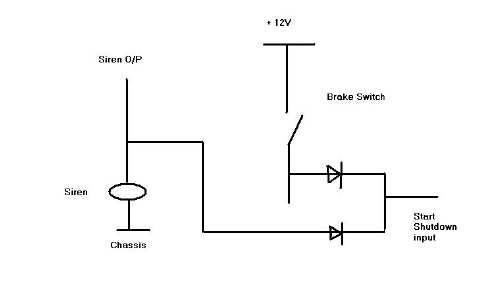

D'Ecosse
Copper - Posts: 49
Joined: October 24, 2004
Posted: October 24, 2004 at 8:52 PM / IP Logged
mo12v wrote:
But R U sure putting 12 volts BACK thru the Alarm module is a good idea?  Can it be done without affecting the PCB or components inside?
12V is 12V - whether it comes from an O/P out of the alrm unit, the battery terminal or the brake switch.
mo12v wrote:
Wouldn't it be better to RELAY the output of the Alarm Siren to the Brake wire
You could, but easier just to connect the brake switch connection & the siren O/P both through diodes into the remote start turn-off. Viper Alarm -- posted image.

<<<<Just use the siren O/P to the brake switch input - use diodes to isolate the siren when the brake pedal is pushed>>>>
<<<< You could, but easier just to connect the brake switch connection & the siren O/P both through diodes into the remote start turn-off.>>>>
I'm glad U re-posted the correct answer
TEKEN:
That would be to simple......Viper Alarm -- posted image.
MO
