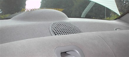

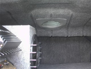

As far as your current question is concerned:  air pressure will fill an enclosed area.  The inside of the box gets pressurized when the cone moves inward, and  the air on the outside of the box gets pressurized when the cone moves outward.  That pressure creates the sound waves.  Air pressure will extend throughout an enclosed area, so if the trunk is enclosed, the trunk will become pressurized.  If the trunk has an air opening into the cab then the trunk and the cabin will become pressurized.  Facing the subs one way or the other has nothing to do with it.  IMO, the port opening on a sub box located in the trunk can open on any side of the box where it fits best.  The port opening should be flush with the box, not extended into the cabin.  That's not where the majority of the pressure is coming from....it's coming from the movement of the cone.  The two pressure sources -- the cone and the port -- should be located together in one common area, which in this case is the trunk....because the output of sound at the port needs to blend with the sound from the cone.
This blend of sound, coupled with the added cabin gain from the trunk cavity, now makes the trunk the "source" of the sub bass.  Aim the sub box for best sound quality while listening from the driver's seat, and create or allow an opening through the well-damped back parcel shelf for the air pressure to enter the cabin.  I used a factory speaker opening in my Taurus for this purpose:

Heh that looks *awesome* .. I've been getting ready to do something like that to my Corolla for my 13W6.. ur pictures have inspired me!
