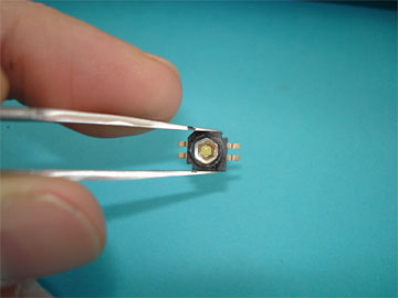

For the fogs I would (and have) use a single Luxeon III led. There small, powerfull and theres a full range of lenses available.
Led Fogs -- posted image.
You will need to use a constant current regulator to drive them instead of just a resitor. Its cheap and simple to make. Heres a single red and single blue running a little over 1/2 capacity. The amber one is just as bright.
