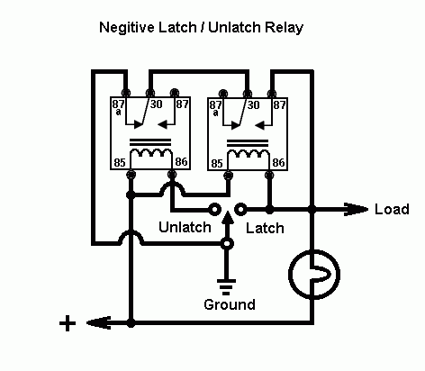

Hi, I am trying to get a neg pulse to stay constant 12+ but also turn off with the neg pulse, i found this pic but dont understand what looks to me is a  push button on off?.
And where would i put the neg input to turn relays on/off..
Thanks

Here is the pic i was talking about,
latching relay -- posted image.

Hi, i looked and tried to make the latched on/off output with momentary pulse with Diodes. using Diodes1N4001, this is a single neg pulse button i am using to activate relays.
But when i tried doing this i had to leave the #1 relay #87A unhooked to turn on the light, then i had to touch 87A to the other side of it which is #3 relay 85 and #4 relay # 87, it sounds like it un latches one of the relays when i do this? now i push the key pad light turns off?  Anyone know why this is? i followed the diagram to a tee.
Thanks

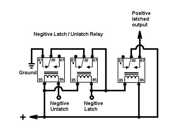

Add an extra relay and here is what you get.
