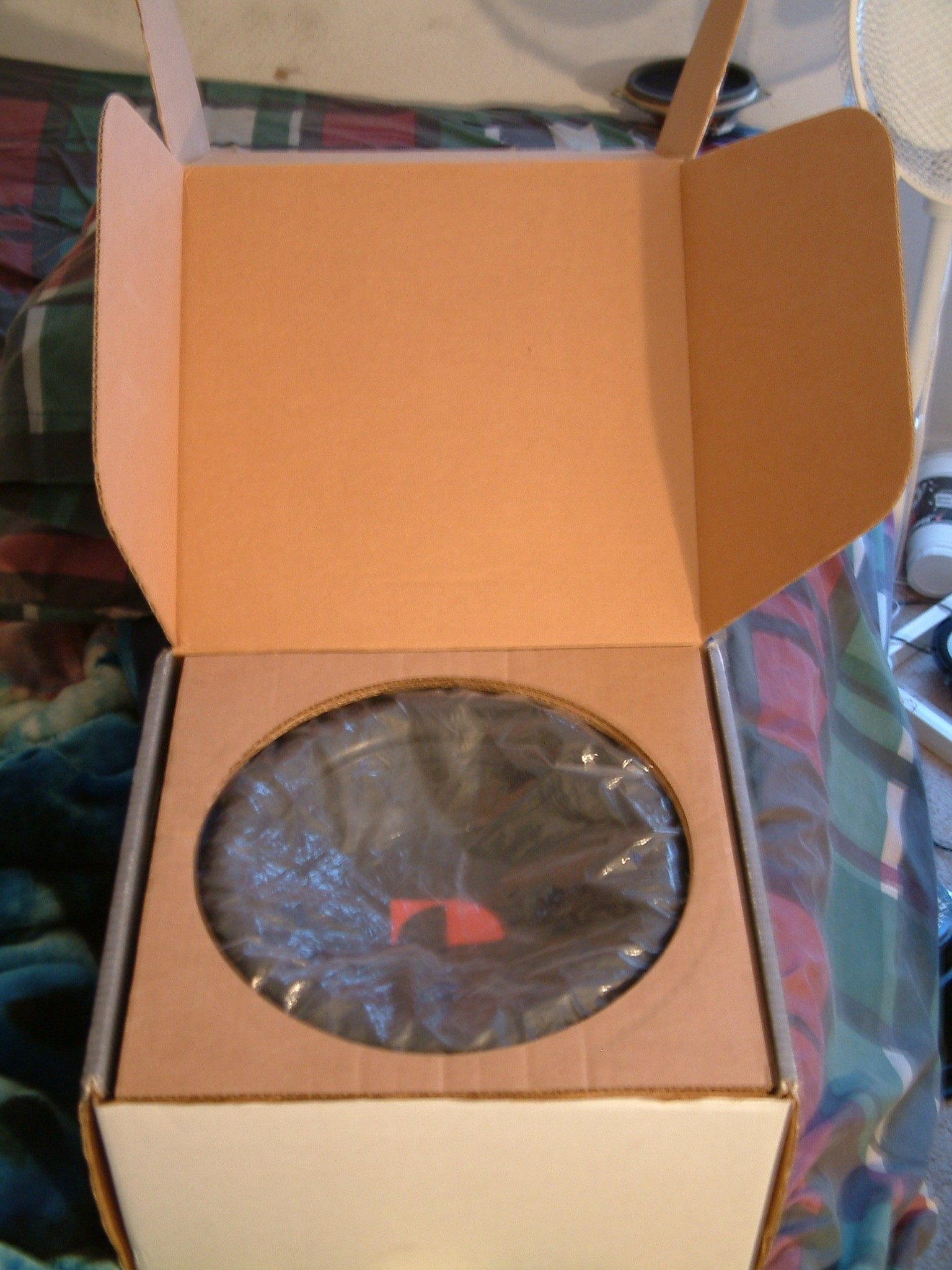

One SPW1200D is plenty. I highly recommend it! Here is a picture of mine (i sold it a couple weeks ago) but it was great! NAKAREVISED.jpg
