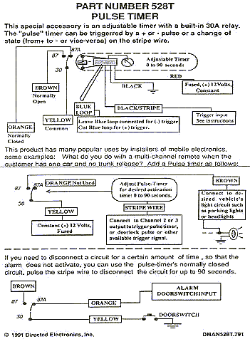

any help or information would be appreciated b/c as of now, im stuck. what im trying to accomplish here, i have installed hid low beam in my motorcycle. i purchased a 528t(timed relay)in hopes so when i start the bike, the ballast would turn on at a set time after the bike has been running. purpose is so i am not stressing my starting/charging system or the ballast by having them both start at the same time.(stock halogens come on automatically when bike is started)i want to know if there is a way i can have the relay delay my headlights on startup. as of now, the relay will only complete the circuit when the acc. is turned off(relay will complete...stay complete for set time... then open) please,any help.

If you are using the Brown wire for your load now
just use the Orange wire instead. It does the oposite of the Brown wire.

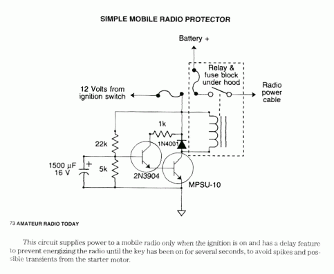

What you are looking for is a Delayed ON Timer.
This may do the trick

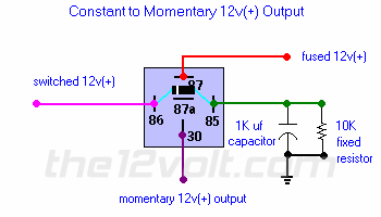

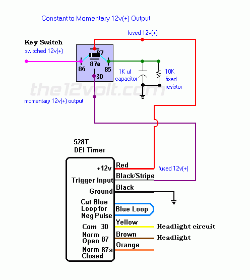

528t -- posted image.Add this circuit where the black stripe wire is and it should do what you want it to.
Constant to Momentary Output
The capacitor allows the coil of the relay to be energized until the capacitor stores a charge, thus de-energizing the coil. The resistor bleeds off the charge of the capacitor when positive voltage is removed from the other side of the coil. You can increase the output time by simply changing the value of the capacitor. This one will give you about a 1/2 second output.
