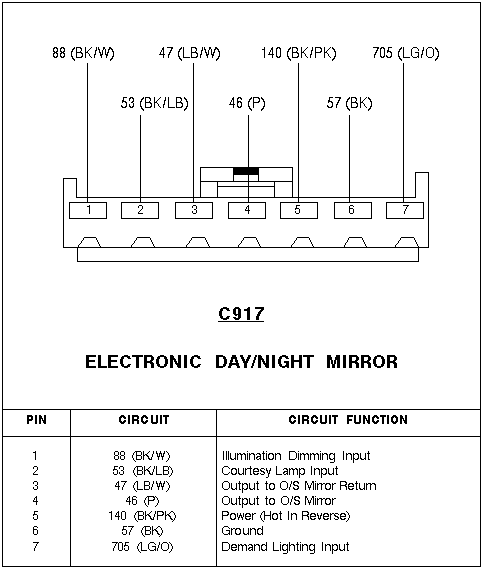

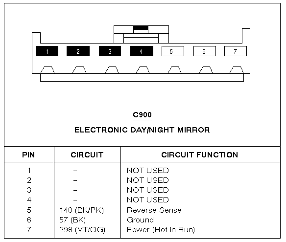

Trying to add a 96 Lincoln Continental rear view mirror (autodim, compass) to my 88 Tbird project. Anyone have the wiring schematic? Thank you
1privateer
Joined: March 25, 2006
Location: Utah, United States
Posted: August 26, 2008 at 10:30 PM / IP Logged
Found this - need to check mirror type on back of mirror
96 lincoln cont rear view mirror - Last Post -- posted image.
OR

I guess I should have labeled the mirror types
C917 = Donnelly
C900 = Gentex
